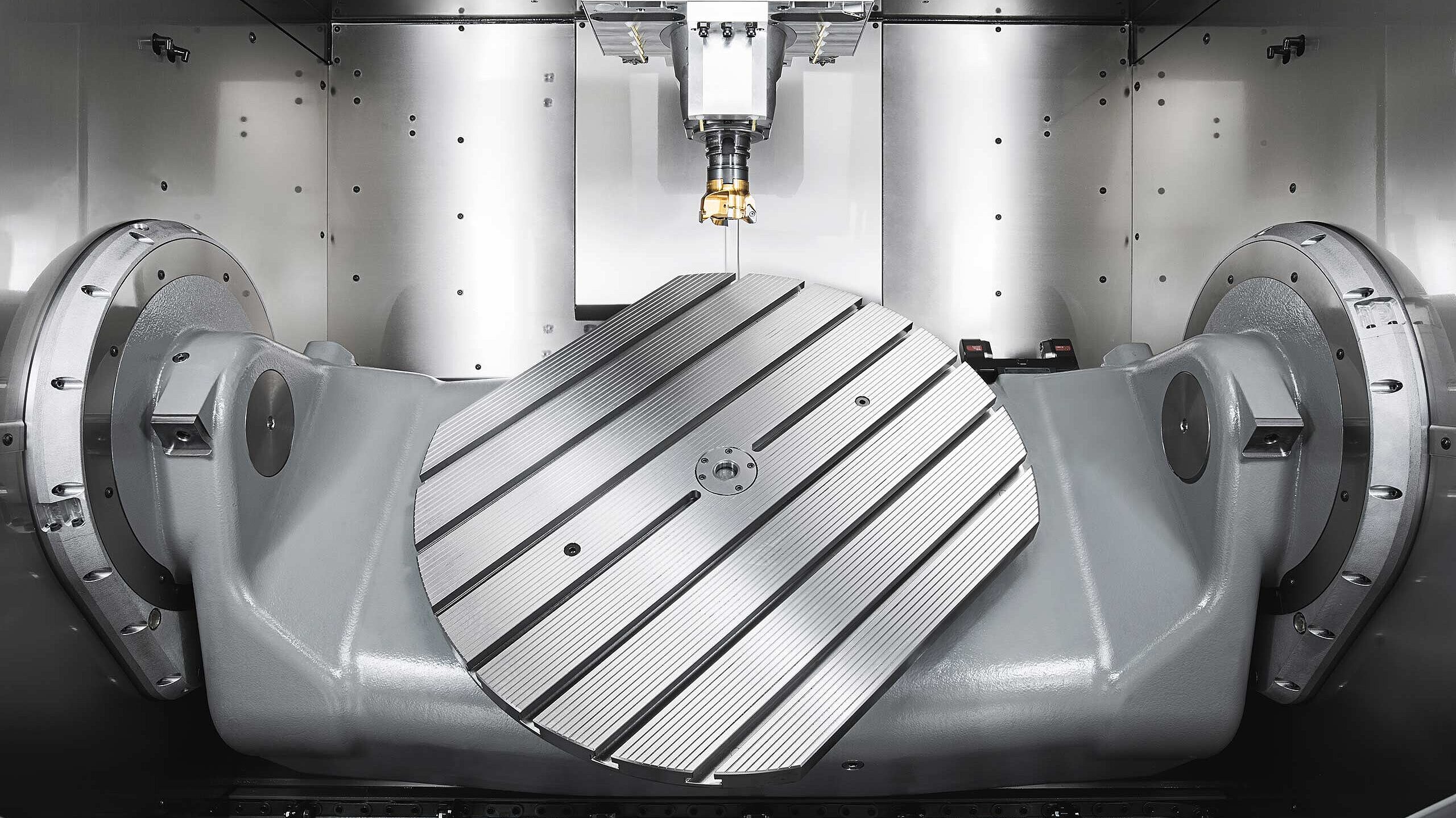

  • Arbeitsraum der C 650 von Hermle mit dem Schwenkrundtisch Ø 900 x 750
    shows the working area with the Ø 900 x 750 swivelling rotary table

Like the C 250 and the C 400, the C 650 uses a modification of Hermle's tried-and-tested gantry-type design, with a mineral-cast machine bed that is manufactured in Hermle’s own brand new mineral casting foundry in Zimmern ob Rottweil. The integrated, rigid clamping table can cope with workpieces up to a maximum of 3000 kg (1050 x 900 x 600 mm) in the 3-axis version, making it ideal for toolmaking, mould construction and machine construction. The swivelling rotary table of the 5-axis version can accommodate workpieces up to 1500 kg (Ø 900 x 600 mm), allowing for highly precise machining.
The traverse path in the stainless-steel-clad working area comprises 1050 x 900 x 600 mm with a vertical table clearance of 775 mm and a door aperture of 1050 mm. Ideal parameters for simple and safe crane charging.
